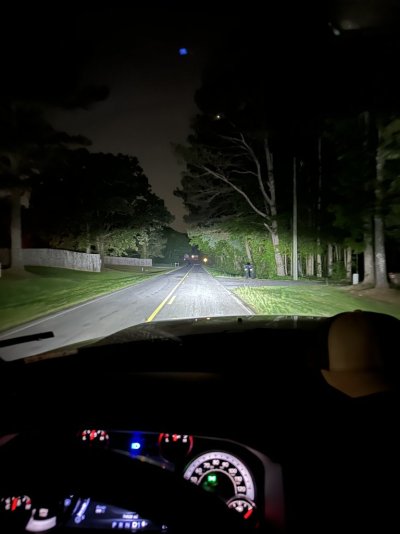

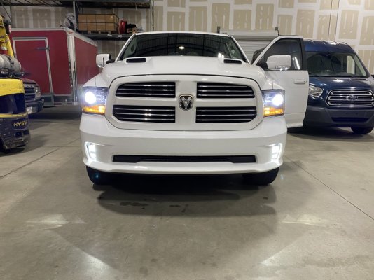

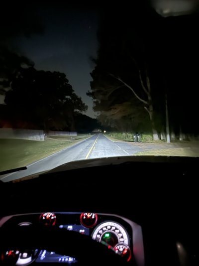

These are what I run in my '17 and my dad in his '14 projectors for low beam and high beam. They're awesome
Low beam
Low and high beams
I’m shocked by how good these look considering everyone seems to say HID’s in projectors are the way to go. Did you need to do anything with alphaobd or were these straight plug and play ?
I also had run these in my old Ford Fusion prior to this, I also was shocked at how well they worked. They were plug and play, no issues and nothing else needed

So do you run this same bulb in both your low beam and high beams?
And even though it doesn’t look like it on your dash but I’m assuming that in your picture where you’re showing the low beams, you don’t have your fog lights on at the same time? Because it looks like you don’t have any shadows like I do with the LED low beams I’m using.
Yep, same bulb in low and high's. Only difference is I've got the lows clocked to 12-6 and the highs at 9-3.
That's correct, first picture is lows only with no fogs and second is lows+highs. I have no shadows to speak of. That's the beauty of this particular LED design, the body is thin enough and the chips are in the correct location for them to throw light exactly the same as halogen lights do, just brighter.
