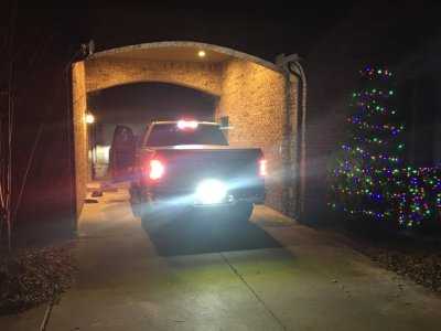

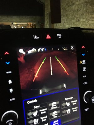

LP-REVERSE LIGHT SYSTEM 5500K WHITE
wired into trailer harness Full black on LED to Black in harness and black with white stripe on LED to white in harness. I pulled trailer connector connector out onto bumper (simple retailer squeeze behind bumper and pulls right out), cut fabric tape on harness, used two inline splice connections, re-taped with 3m fabric tape from Home Depot with zip ties at start and end of tape. Looks factory and secure. Plan to smoke the bar to hide the LEDs.

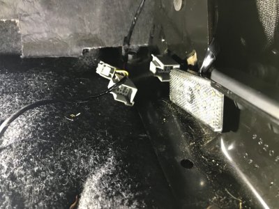

I posted this before . But I am sure it is buried ! I installed rear under seat light . I used 2 cheap LEDs. They are OK but not really bright ! And the OEM electrical socket I will change them later ! My wiring harness was already there ! All off E Bay less then 10$

What an excellent response. Thank you. After my first comment, I did some research here and read the entire thread dedicated to the lights. Seems the majority of people are having some rubbing on their tailgate due to the design. Response from the company has been prompt and they added the note about fitment on our trucks as a result.
You having the same problem or are you one of the lucky few that clears?

Completely clear, the light bar is very low profile on top of the license plate and the wire runs behind the plate through an existing space with the included rubber grommet holding tight, less than a 10 inch wire run from there (to include the integrated inline disconnect on the wire) to the zip tie on the trailer wire harness. No possibility of rubbing anywhere on this very short run.

All works well.

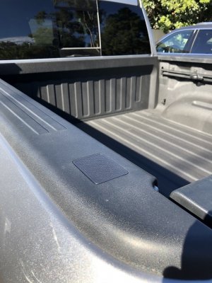

$12
noticed a reduction in cabin road noise
push pins attach to 5 existing holes in lower front edge of box
fyi > deleted on builds after mid 2018View attachment 162421
4th Gen guys have been removing these things for years as they rub the paint off the back of the cab. Some have just trimmed them down a little but most I believe just leave them off. Keep an eye on yours if you add it.

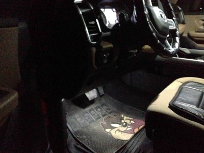

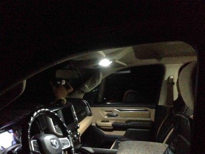

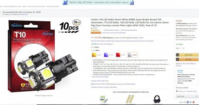

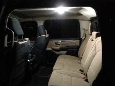

Changed all the interior lighting on MY 19 Bighorn to LED, except for bulb in Lower Glove Box. I have OEM LED (exterior ie, headlights etc) except for Cargo, which I left alone since have full tonneau cover.
IMG_0798.JPG IMG_0799.JPG IMG_0800.JPG LED FESTOON DOME.JPG LED Interior.JPG
