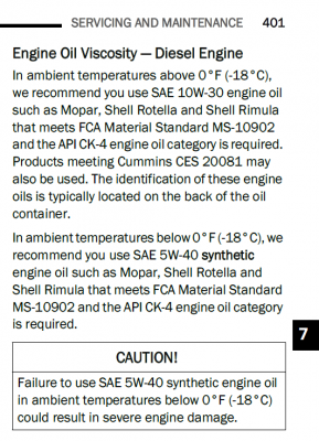

The owners manual makes no mention of using synthetic oil in regards to warm or hot temps.
It says nothing about synthetic oil being "better" for the turbo.
The manual says 5w-40 synthetic can be used for all temps but is "required" for operation at below 0° F temps.

It's difficult to find a reputable synthetic oil that fully meets the specs recommended in the owner's manual. It turns out 10w-30 is not as common as 15w-40. It's hard to find a synthetic 10w-30 that meets MS-10902 and API CK-4 and/or Cummins CES 20081. Currently available oils seem to be more commonly rated CES 20086. Is that interchangeable?
See owner's manual excerpt here:
I also found this online indicating CES 20086 is comparable to API CK-4.
You're overthinking it. it's just oil.
This Mobil Delvac Extreme 10W-30 meets the Cumins CES 20081 spec and is available at walmart.
It's $11.78 a gallon or $35.58 for a 3-pack.
Personally I'll be using the Kirkland 15w-40 which does meets Cumins spec from now on. It's only $26.99 for a 3-pk. I have no need for synthetic oil for use at below 0° temps.
