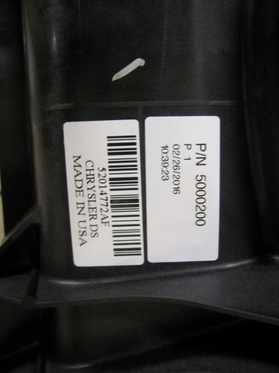

Hi All...New to the forum.
Sorry to bring up an old thread. I recently got a 2013 Ram 1500 5.7 and have been researching the v6 efan replacement. I did some searching of part numbers that were listed in previous posts and found this:
https://www.eastcoastmoparts.com/oem-parts/mopar-fan-module-52014772ad/?c=aT1UTTEzMDQwNSZyPWxheWVyXzE%3D
From the diagram it looks like it's exactly the same as the one that Hipps2000 installed, although he said his was a different number. When I search the number that he gave, it looks like it's the fan without the shroud (which is what it sounds like I do not want).
https://www.eastcoastmoparts.com/oem-parts/mopar-elec-cooling-fan-55056851ag/?c=aT1UTTA5MDQyNSZyPWxheWVyXzE%3D
Can anyone confirm? Thanks!

The part number I posted is the correct fan...ram also updates it’s part numbers at the end by yearly updates for example AD to AE to AF to AG now. I used an AF I believe. It the part number I posted was for an oem fan. Installed perfectly and plug and play.
Also my fan came with shroud.

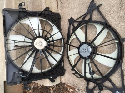

Here is the difference between the 2 fans. There is a difference. V6 fan is better design... the oem fan has been flawless for me as well. I even ran it for a few months before I finally got my 180 stat and polished neck installed. Truck ran about 200-220 now it’s tuned for 180 and runs 180-190. Very happy!

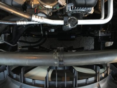

Plus it has a nice upper rad hose clamp built in.
