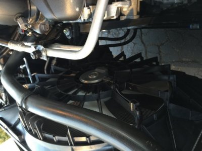

The original fan part number was 55056851AC the. It went to 55056851AD, 55056851AE, 55056851AF. I just bought won and scoured the Internet, best price. Found for OEM part 55056851AF was $329 plus ship $370 to my door from east coast mopar. The part used to be about $175 couple years back but all dealers retail it now for $470. So I call BS on $200 it is not oem mopar but a copy...there are many aftermarket versions.
I just completed the ATI pulley and efan mod and am very happy with it. The mopar fan works flawlessly and is quiet. It also has the radiator hose mount and really opens up the motor area.

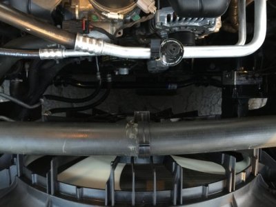

Pic of fan

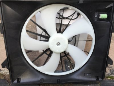

Pic looking down

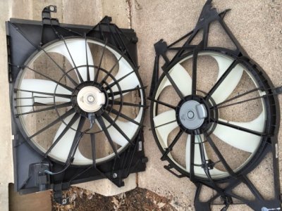

Also I have a 2013 ram and the fan that came with my late model production 7/2013 had the identical fan as the v6 fan but no shroud or built in thermostat. Also was missing the rad hose attachment. If you want oem and the right fan buy the one I posted above part number 55056851AF. That is a mopar fan and fitment is perfect as well as runs perfect as I havnt switched my thermostat as of yet. So just drop in... plug in... And done.
Here is a pic of the fan that came in my 13 and the 55056851AF side by side.
