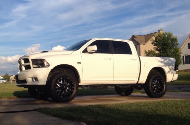

I have the Zone 4"F/3"R with Bils set at 1.4 and I have 3/4" of rake ... Get the upgraded Fox shocks for the rear ... They ride great ... I'm runnin 35'sc9af48b7bff1fcff3a2e5ba01a634cf4.jpg

I second the recommendation to get the Zone 4" Lift with 3" Rear Coils, and upgrade to Fox Adventure Series or Fox 2.0 Performance Series Rear shocks. If you want to maintain close to your stock rake, and you are happy with your stock ride quality; then you can maintain your OEM front struts; rather than replace them with Bilsteins like many do to level their ride.
I just got my Zone 4" Lift with 3" rear coils and Fox 2.0 and love it! I also wanted to maintain some rake, and opted to get the Bilstein 5100 for my front struts and set them at 0.7". I started with 2.75" rake. I ended up with 1" rake. Had I kept my stock OEM front struts, I would have been closer to 1.7" rake. By keeping your OEM struts, don't think you'll have to mess with your ball joints/UCAs, and save $200 cost of Bilsteins. Though the Bils do seem to ride nice. If you really want the Bils, and don't mind the cost upgrade; I suppose another option is to replace your OEM struts with Bilsteins and set them at ZERO to maintain your desired rake.
You can purchase a complete Zone 4" lift with 3" rear coils and Fox shocks that'll look sweet, ride great and simply reduce your rake by 1" (hardly noticeable). Plus you won't have to mess with your front end to get the look and ride you want. Here's my before/after:
