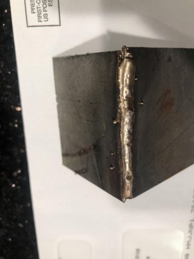

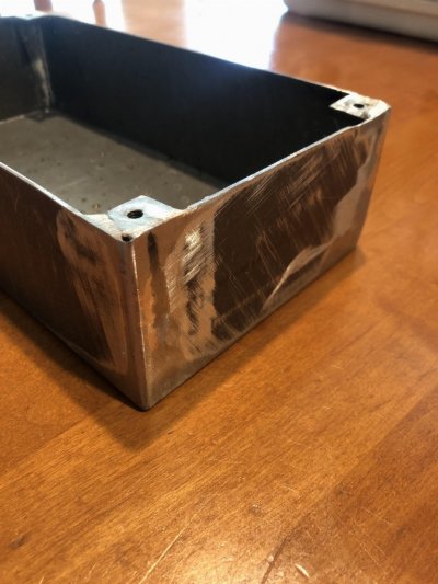

TIG is definitely the way to go for sheet metal, But is an extra jump in skill level.
I have had pretty good luck with using silicon bronze and pure argon on sheet metal
Here is a little 20 gauge box I migged up for an electrical junction, with .025 silicon bronze ... no warp, no keyholes
