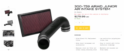

not sure im doing anything Just yet. But i would eventually like to get a Tune and some other stuff down the road just doing research . for now would this mod be better than wasting $ on a CAI or ram air intake. im thinking it would.
get the the lower box+ boot , removing carbon filter and getting a cheapo drop in aem dry filter?

I added this to it recently. I'm not sure if it's just a placebo, but I think I could tell the difference. Especially in the upper RPMs.

ill look into this.
for those with 2020-21 models
i see there is 2 part numbers for the same kit any one know why and whats different on the 2 ?
301-780
300-780
Matts175
Feb 10, 2019
299
225
Michigan
ill look into this.
301-780
300-780
On one, you get a dry flow filter, on the other, you get an oiled one (like a K&N). I personally got the oiled one because I travel "Up North" several times a year and it's all dirt roads up there.

i ended up not getting the kit and went the lower box / air boot and drop in aem filter. parts from oem part source shipped came to 67$. add the Aem Dry drop in filter amazon for 44$ shipped . 111$ total. i can live with that . being on another forum i did mention later on down the road ( couple years) once warranty is out. i will likely end up doing the 6.4L intake manifold / jays tune and long tubes no reason to spend another 144$ extra when i wont be able to use any of the parts then being on the 6.4L truck intake manifold the TB sits different so the 5.7L box or aftermarket CAI will not work .
*** EDIT- NOTE IF YOU HAVE A 2021 the lower intake box / boot will not work. the 2020+ part may but its 170$+ not worth it .
