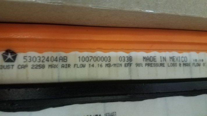

Does anyone know the actual difference between the airflow CFM of the standard 5.7L air filter and the 6.4L / 3.0L EcoDiesel air filter? I can't seem to find this info anywhere. Thanks for any help you can provide.

If I still had my original 5.7 filter, I could help. The filter information was printed on my original 2016 air filter - mopar replacement does not have the specs printed on it.

I don't have the original one but I have a replacement Hemi and the 6.4 EcoD Mopar filters. They have some flow info printed on one side...
Cool, my replacement mopar filter didn't have any writing on that I saw.
I would not have imagined that the Eco D would have less dust capacity than the shallower filter - hmmm.
I am assuming (maybe incorrectly) that the5.7 hemi is cubic meters/minute and the 6.4 is measured in gallon/second????
If so 14.16 m3/min = 62.345 g/s at a less efficiency than the 6.4 filter but am unable to see pressure loss info on the end of the 5.7 filter

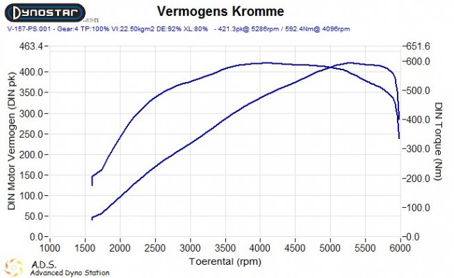

I have don it, does it give some extra? I don not know.
Made some more mods (LT Headers cats removed Resonators removed Magnaflow exhaust bigger TB E Fan and 8 hours tweaking the ECU) and now we have this Dynosheet :

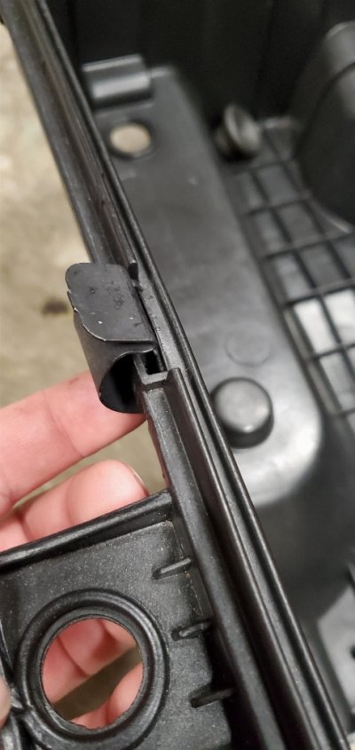

I'm in the middle of this mod... is there a trick to swapping the hold- down clips?

Yeah very carefully lol. They come out a lot harder than they go in the new box. You have to pry them pretty hard to get them out....

Ok. I've broken two, so I'm just going to break the other two (plastic on the housing).
Any trick to get them on the new one? Any special way to pry it? Or did a certain tool work best?
Let me take a look at mine. I ordered extra clips so I should be able to get a pic....

Grabbed my 5.7 box, you want to position it like I have it in the pic and pull up. It should just snap into the groove on the box....75848d1407d7a0906ac54387a09e7e22.jpg
