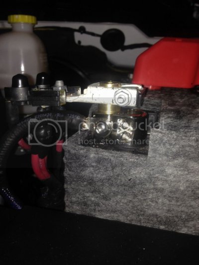

I have done the big 4 same as big 3 but I upgraded the motor to body ground will get pictures later

Im about to do the big 3 myself. I know how Im going to run the wires, but what is the best way to connect them to the battery with all the crap they have hanging off of the battery post? I dont see a way to get aftermarket terminals on there.

I bought negative and positive terminals from knukoncepts, with adapters to move the factory leads to the top of the terminal
Could you post a pic of your connections at the battery?

I actually haven't installed yet. I'm in CT, its still snowing and cold, but when I do install, I'll definitely post photos
