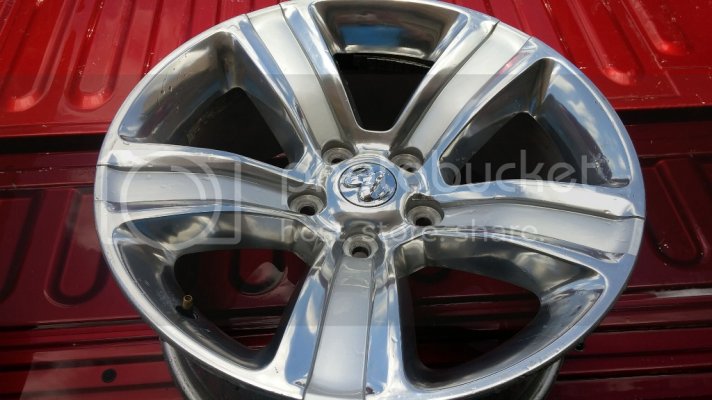

Are those wheels R/T replicas in a 20"?
Those are the Sport model wheels. They are somewhat similar to the R/T wheels though.
Here they are up close.

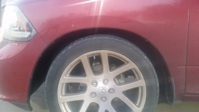

Here's a pic of how low I am on 305/40R22s.

where exactly are you rubbing on the fender liner? I'm wondering if it's because of the 305. I know there a ton of guys running much more drop that don't seem to be having the problem, but they all run 22s and narrow rubber band tires. If you follow "ram_trucking" or "ramloyalty" on IG you will see a ton of guys with slammed static drops.
Could you mod the liner at all? When I had my 2010 F150 I had 4.5/6.5 drop with 305/40r22 and I had to heat up the liner with a heat gun, push it back with the head of a big dead blow hammer, and hold it there until it cooled down. I basically just remolded that spot of the liner where I was rubbing so it would clear and I never had any more problems. Just a thought.

Well for starters my current tires are smaller in diameter than the stock 22" wheels and tires the R/T comes with, and those are smaller than the stock 20" wheels and tires on these trucks. I should have MORE fender gap than a stock R/T or Sport.
