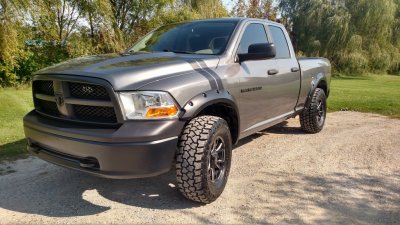

So just so you know I don't have a pw but I just went to 295/70-17 MasterCraft cxt on my leveled 12. Other than E ratted they are 33 1/2x11 1/2IMG_20200926_112003361_HDR.jpg
