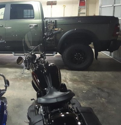

The 35x12.5x17 Yokohama X-MT’s on the stock wheel.
View attachment 223250 View attachment 223251 Current setup that I may take off and save for off road trips, haven’t decided. 315/70/18 Toyo’s.
Hi, new to forum as I have a 22 PW on order and searching for best tire and wheel upgrade when it arrives. The 315/70r18 (36”x13”) Toyo seems to be perfect balance of a little larger than 35” but maybe fit better with less rub/trim needed then going 37s. Can you please let me know your wheel offset (I’m thinking of +18) and if you have any rubbing or had to trim?

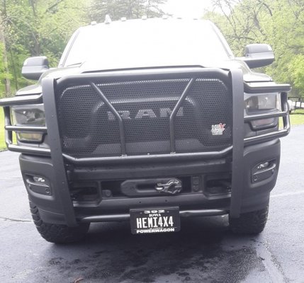

For 35" inch and up tire size on the 17" wheel there is little available (one choice) for tall and skinny on our Power Wagons. Going even narrower than the OEM 285 width with a 35 10.50R17 Kenda Klever R/T would be it.
Going to 35 12.50R17 tires next month on my Power Wagon. Tire size availability and its function are the reason I am changing sizes from running a 285 75R17, not for looks.

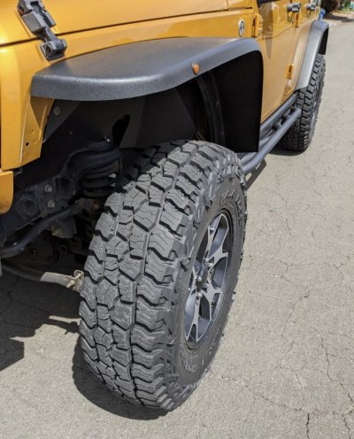

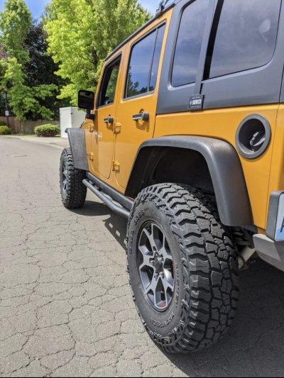

I have been reading nothing but rave reviews on the newer mickey thompson baja boss at. I also see they have this in pizza slicer size for a 17” wheel (255x85/17, which is basically 35x10.5). Its e rated and has the 3 peak snow rating….and its made in the USA.
I feel like this would be one hell of a tire for a stock power wagon.
I drummed up some pics of them on a jeep…

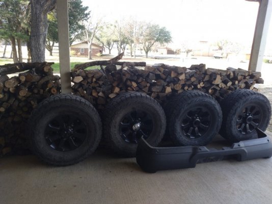

I just happen to have a set of 2020 PW wheels with Toyo RT 35x12.5x17 tires with +-60% tread available. PW8.jpgPW7.jpg

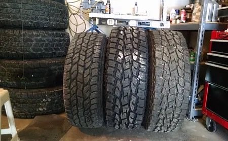

yup very little difference here are Toyo at2's in 285/75-17 and 35x12.5-17 I ran both flavors on my jeeps. they make a cooper at3 in 285/70-17 look small the 35 is in the middle.
I have been looking high an low and can not find them in stock. perfect winter tire on stock wheels.
Its crazy, that going by the numbers the 285 should be over an inch skinnier but close to the same height. Sure dosnt look that way…at least with toyo at2’s.
