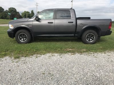

Anyone running bilstein sat 1.4? Pics? Have them on garage floor now but getting worried after reading some other post, was planning on 2.1 now I'm not sure.

I just installed mine yesterday at 2.1 and I love it. Also put 1" rear spacers as well

2.1" will be totally fine. I would not run them at 2.8" as you'll be more likely to have ball joint issues.

Agree, one's mileage varies on this point. I had a serious rake and opted for 2.8. Have them on now for a couple years on my 2010 with no issues. Also running 305/50/20s on 20x9 +1. Only slight rub at full turn.

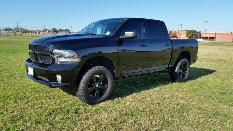

Before putting them on, I would take good measurements of their fender heights to see how much rake there is. Depending on your rear spring, 1.4" may put you really close to level. When I had my 2014 1500 4x4, I set mine at 1.4" and I was about 1/2" of rake. But, visually, it looked level.

Nope, it was an express with the blacked out package
Don't think I have any pics with just the Bilsteins at 1.4" Shortly after the bils, I went with a 4" superlift... here's a pic with the 4" lift + bils @ 1.4 riding on 295/60r20s and stock wheels
