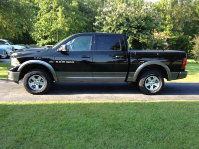

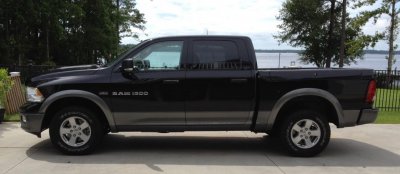

Thanks for the reply fellas.
Put them in this morning at 2.75, and had the alignment done. No wobble or vibrations at 4wd up to 35mph, 2wd up to 75mph.
Ground height at wells Before: F 36.5 - R 39.5
Ground height at wells After: F 38.25 - R 39.5
So being set at 2.75" gave my 2012 Outdoorsman a 1.75" nose lift.
I am very happy with this, it looks just a little nose down, which is what I was hoping for because I like a tiny bit of rake, visually and for highway speed stability.
Thanks again for the help guys.

Nice level!
Its crazy how all you got was 1.75" when it should have been closer to 2.75"
Any idea why?
None the less....being closer to level looks better than 3" of rake ;)
