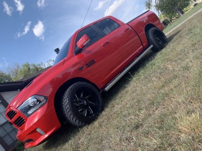

Have a picture of yours by chance? And did it improve or affect your ride at all? Anything you wish you may have done different?
Yep, here you are. The ride is substantially better than stock.
- Brake dive has been reduced
- Body roll has been reduced drastically (no longer feels like a boat, my favorite improvement by far even more than the actual lift itself)
- Absorbs small ruts/sticks/rocks etc. during trail driving much better
- Although raised, the truck feels far more planted
The only thing I'd change is perhaps adding a .75" rear poly spacer. I'd like a tad more rake for when I load a few hundred pounds of sand in the back for winter but thats about it.
