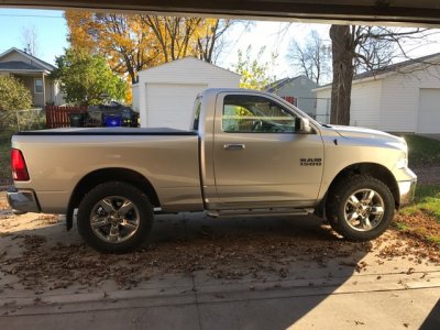

I have 295/60/20 Terra Grappler G2's on chrome clads and they fit just fine. My 5100's are set @ 2.8".

Stimpy those tires look good on your truck.
