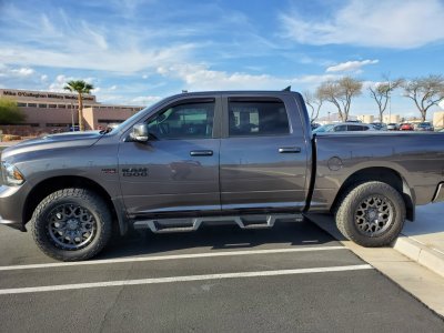

bils at 2.8 in the front + 1.5" icon coils w/bils shocks in the rear = level perfection :)

Yup. It's mounted on Black Rhino Sprocket 9.5" 0 offset
