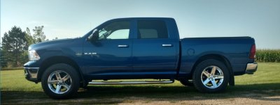

Well here are a couple of pics. 275 65 R20 Falken AT3's. Crazy how small they can still look on these trucks!
