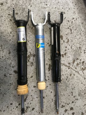

Looking at thefront struts for the 19s. They measure the same as an 18 or older I’m going to try a set of 5100 leveling struts for the old body style on a 19. Will have them Tuesday hopefully

Should be fine.

They are different looks like at max lift the bilstein would be only as high as the stock 2019 strut

19 ram on the right 18 on the left

Ended up putting a mopar 2 inch lift the bilsteins would fit but if you look at the picture the stock 19 struts already have a higher spring cup placement

But if you where going the other way the would probably work to lower one

This is the only one I have the 19 ram strut is on the right the one without a bump stop

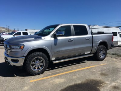

No lol I mean of the Mopar 2” lift installed onto your Ram. :)

No it was not going to achieve the lift we wanted so we went with a mopar 2” lift

Good to know, thanks! Looks nice
