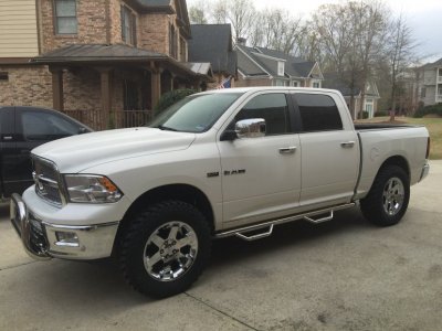

Got my blisteins in about a week ago and also added some 35" firestone mts. Still have a lot more wheel well room than I expected. Only thing is that they are still on stock wheels and I want the tire to stick out a little more. Im not a big fan of wheel spacers but should I just go with one for now until I get new wheels? I do some off roading but its mainly gravel roads and stuff like that. Nothing too serious. What do you guys think?

You'll be fine with spacers. I ran some 2" on my old for like 80k miles with no issues. Just make sure they installed properly and that you retorque them every tire rotation

Did you go with 2.8 setting?
Tires look sweet too.

Yeah I went with the 2.8 setting and I like it. I was going to add rear spacers but its looks pretty even to me so I'm probably going to leave it as is. Still deciding on wheel spacers though. Im scared that wheeling might cause too much stress on them. I had a jeep wrangler with wheel spacers and had one break off. Luckily it was in the driveway and not on the road.
