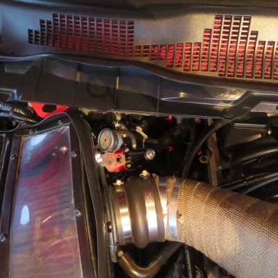

Now that you’ve figured out photos, let’s see your nitrous setup! I’m on the fence with a 50-75 shot that Jay can shut off at 100(Km/hr). *wink
Not much to see Tim,it's all out of sight or diguised to look like factory lines.I can show a pic of the stand-alone fuel cell and relocated battery in the box though.
Fuel cell up front/battery at the back
The only thing that sticks out,is the adjustable fuel pressure regulator mounted to the back side of my airbox,and is for the stand alones fuel pressure

clean, sleeper, bottle in cab? How are you triggering, window switch?
