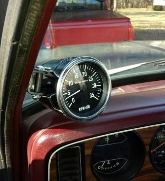

Installed the Dynamic timing mod, DE 4" exhaust and installed the sensor for the tach. Got a Denny T pin and spring yet to install, but want to get the gauges in first. No rush while it's cold outside...

Been trying to install a tach. Thought I'd be clever and use the 93 harmonic balancer and OEM pickup without using a PCM. Installed the balancer and pickup. Did a Zener diode trick to get 8vdc to supply voltage to the pickup, hooked everything up and it worked up to 1400rpm and then would lose sync. Pulled the OEM pickup off and installed ISSPO magnetic pickup and it works great.
