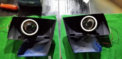

been working on these for a couple weeks, bad weather and cold temperatures have slowed things down, but here is my progress so far.

Actually for me, baking them open was quick and easy, but the headlights i used are not factory, amazon has a projector kit for less than 30 dollars that i ordered because in needed shrouds faster than TRS could get them to me. the projectors in the kit are actually pretty nice, we will be using them in my sons headlight project on his GMC canyon.
Patients is the key, im finicky about painting so i took my time.
The mounting wires on the halos dont bother me, i feel more comfortable that wont fall off running down country roads, my wife didnt notice the wires until i pointed them out. i will be using the halos for drls and added turn signals.
The cooler thing to me is when i turn on my brights i will have double the light output, due to the gat dropping and brights coming on.

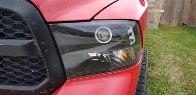

Project is done, i forgot to take pictures of some of the modifications, sorry. They are very nice though. First picture is xutoff comparison.
