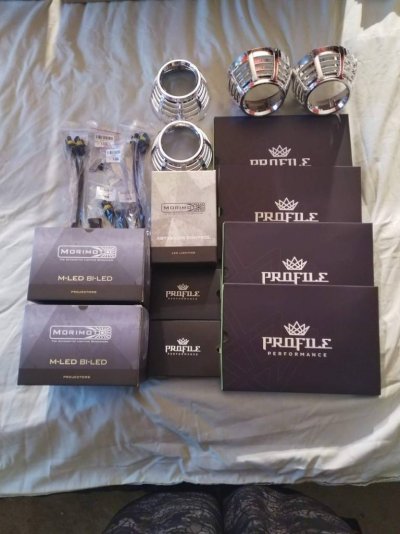

Just got done building these. The lenses are not sealed in these pictures so they have fingerprints and dust on them. They will be way cleaner when I go to reseal them.
Whats Inside The Headlights:
- OEM 09-18 Ram Quad Headlights
- Morimoto M-LED Projectors (low beam)
- Profile Performance Hi-Lens Multi-Lens LED Projector (high beam)
- Apollo 3.0 Black Series Shrouds Custom Fit
- Profile Prism RGB Demon Eyes
- Profile Prism 70mm Halos
- Profile Prism 09-18 Ram "Fitted" RGB Halos
- Profile Performance 3157 Switchback Bulbs
- Morimoto HD Resistors for 3157 Switchback Bulbs
- Morimoto XBT Bluetooth Controller
- Morimoto 9006-H11 Adapter Plugs
- Morimoto Hightbeam Spliters
- Morimoto Stand Alone Canbus Adapters (for low beam)
- 4 TRS Cable Glands
- Custom Black Paint and Silver Mettalic Paint
+ tons and tons of other little things I cant remember at the moment.
--- Pre-Build Pictures:
