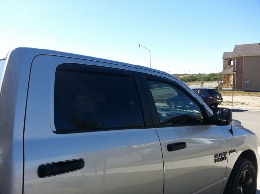

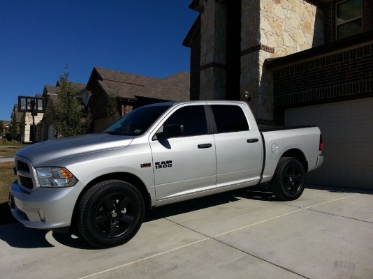

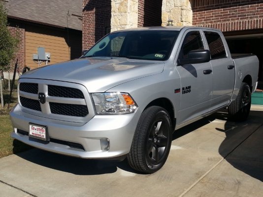

odd........the new express doesn't have the vinyl.......

Safetyman, that came out very nice. I need to find out about peeling tape for Plasti-Dip. How to peel it without pulling the Plasti-Dip off.

I was told if you tape that once you spray peel the tape right away so it doesn't have time to set.

Mask off everything around your area, leaving ONLY the tape left that you are going to remove for last.
I did 6 coats, didn't wait but maybe 5 or 6 minutes between, but hit it with a hair dryer.
MY theory, and I've carved and painted a ton of duck decoys, is that if you let the paint set too hard, the next coat doesn't get enough "tooth"
The 5th and 6th coats are the only ones that I put on what you might call heavy....
As soon as you finish coat 6, and I mean put the can down and start, As SOON as you finish, peel your tape for your line. If you allow the surface of the dip to skin, you will not have a clean line.
I did my Hemi badges the same way...
