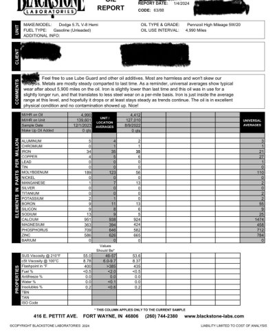

Got my report from blackstone back today. I had used Lubeguard this time around.
Do you have a lifetime warranty?
Hemi's are high wear engines, but imo for 139k miles on truck, that iron is too high to not do something about it. There is a glaring thing showing, that viscosity like hemiman said. I'd consider moving to a stout 5w30, 0w30 or even 0w40 super class oil. That additive package looks middling for sure, not PP high mileage? Do you not use synthetic oil? I have not seen zinc that low for some time. If you want some ideas we are open for business over there, if not it's ok generally this report looks good, it's just that it can be better and fairly easy to achieve. Some synthetics are not much more.
Join syn thread to further the conversation.
Burla,
i used Pennzoil platinum high mileage full synthetic 5w/20 Along with a bottle of lubeguard. I will move up to 5w/30 next oil change. Motor is good and quiet at starup and running temps. Throw some ideas at me im all about learning even at 63 :)

Burla,
It seams like pennzoil screwed the pooch on the formula that time, zinc should be up near 700, especially with a high mileage oil. I generally like that oil and I would say go for 5w30 same thing and see where you end up. I for sure would go lubegard again, if you see the phos between those runs lubegard run was good phos which is very protective with the moly and zinc you do have. If you stay at 5k interval I would not bother with tbn as you have been doing, good there. But eventhoug this is 0w20 your numbers should have been close, as you see no boron as well also troubling. So tthat was recent but gf5, if this is the new gf6 pennzoil platinum hm formula and I have to think it is, I might move off it.
I tried redline once but engine was not very quiet as before thats why i went back to pennzoil syn. if pennzoil changed the formula what oil and viscosity would you then recommend?
5w30 for sure, the other guy 0w30 because he is concerned with cold performance. Once you fix the iron numbers, see where alum is, if alum increases then move to 0w30.
