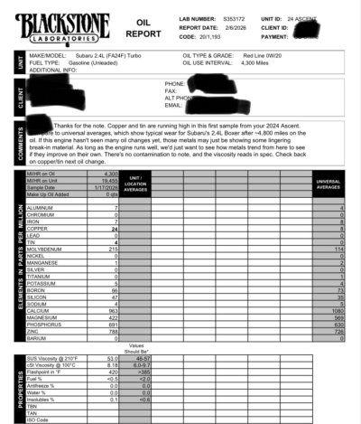

Adding the UOA from our Ascent since there has been a lot of talk on twin turbo GDI engines.

What a great report for a young engine, with no appreciable fuel dilution. What redline did you use? The CA/MAG levels are great for di turbo.
The tin is from the redline not the engine, known thing.

You can see they changed the formula, our resource at redline is long gone, but it looks like that oil is very nice for di's and their old formula was more like their 5w30. It would be nice if they had their di formula separate, but we now know their 0w30 and 0w20 are great for di's and perhaps other engines as well, but especially di's.

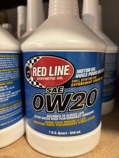

I used this one. I have a 5w30 rotella multivehicle in it now. Was a little nervous about the thin oils and saw this had good results on the ascent forums. Engine definitely quieter now, no surprise. I had been using the redline in our odyssey until it was totaled. So i'll have to work in the rest of the stock now that i feel good about results.

I'm kind of mystified why Red Line would be needed for a DI engine? Aren't lower cost oils sufficient?
I'm referring to our discussions about cleaning capability and higher viscosity for turbo DI's. Red Line ester keeps clean but does not clean. Hence Valvoline R&P and M1 ESP. Both cost far less than Red Line.

Dave had told us the original redline reformulation for the di turbo was their 0w30, so for me I was surprised about the 0w20 also being for di's, though I guess I should have expected it, to me a pleasant surprise I had been asking for redline to make di oils ten years before they did. There are a couple clicks with redline usage such as hemi's and harley's but also BMW. And I'm sure they were pressured by that BMW crowd to make a super oil for a di turbo, as most 0w30's are really best effort oils for manu's. Literally every 0w30 is synthetic so that's a start, but if you looks at the euro 0w30's you see redline had to up it's game to be able to call themselves a high performance oils.
If I might be so bold I would suggest you look into all of the available 0w30's, anyone that previously was committed to redline it sounds like you don't mind spending good money on the best oil. M1 esp 0w30, redline 0w30, Valvoline euro are all good choices. Not sure I would use HPL 0w30 sc it has way too much calcium, which is why I would have preferred they used more mag then CA for the current modern di's. You do want moly as moly is a lspi quencher so decent moly, low CA and high visc in grade is what I'd be looking at first. A lot of voa's on the oil you have in there now has zero moly, hope that helped.
