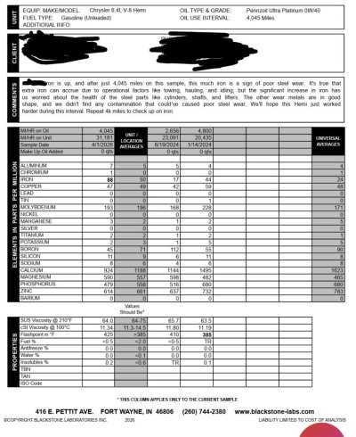

Last two runs were the same oil or was that a mis type? 0w30 last time?
That is hella interesting 3 runs vrp and you can see the increased wear alum and copper with that product.
Interesting the lowest iron wear was the run after the biotech but then went back, and not the current biotech run. Possible theory that run still had some plating going on from the biotech run, but the actual biotech run didn't present because it takes time to plate, by the third vrp run "perhaps" the plate from the biotech run was washed off. Yes this would be not even a theory but a possible theory, as it does make sense with the current knowledge in syn thread. Of course it could mean nothing, but awful interesting that 4 iron wear. I cant wait to see the 0w30 SC as I believe it to have esters like biotech, lets see how iron wear is effected, maybe if will take another run after, so if you are going to keep running uoa's, you might want to commit to the 0w30 SC for at least 2 runs. Best oil on paper we know of that 0w30 SC.
One variable I failed to mention, the first run on HPL PCMO, used Fram FE2, second run on HPL PCMO used Fram XG10060...last two runs on report.

Imho, that ain't gonna matter ... an oil filter trapping particulates vs the oil itself in the sump where the sample is taken? ... matters with an oil report, unless your sample is directly from the oil filter ... ?
JHoward
Jul 26, 2021
1,486
4,278
NW Louisiana
... in other words, an oil sample taken from the sump on an oil drain isn't going to show the same results? as to what may have been trapped in the oil filter, so an oil report is based on the sample taken from the "oil pan" during the oci drain ...
Absolutely, a good idea to use a quality top notch oil filter, but an sample collected from sump is what actually sets the wear numbers ...?
I tend overthink things ...

Not the Ram but this is the Grand Cherokee's first UOA. Its not going through coolant from what I can tell and its running perfect. Coolant isn't milky and neither is the oil.
Looking to get some opinions on this before I get too upset.....

How smart it was to get a uoa, and this is why you get uao's, sorry to hear it but better to know on this one.
test the exhaust gasses, easier then compression checks.

I use 2 different Archoil additives in my fuel and neither one rised the potassium levels in my oil, I list all fuel additive when I send in my UOA samples, my suggestion is to use a different/better oil lab like Polaris labs, they are a spin off from Cummins/Fleetguard, both Amsoil and Fleetguard UOA kits go to Polaris labs for testing and they cost less than Blackstone who still uses older test equipment... JMHO
Don't know if this will give you any insight but I will offer it up.
My 2017 RAM has the same engine as your jeep. Mine is what is often referred to as the PUG or second generation of the Pentastar. I am guessing that yours is also as I see you are using the Jeep recommended 0W-20 oil.
I used 5W-20 pure synthetic initially ( recommended by owners manual ) and have flip flopped a couple of changes with 5W-30 full synthetic. I now have 92,000 miles on the truck with 5,000 miles on the present oil. Just returned from a winter in Florida. Miles are pretty much all highway. Truck is running fine with all engine parameters remaining unchanged. i.e. coolant temp., oil temp and pressure. Mileage remains good @ 24-25 MPG. ( 2 wheel drive with 3.21 gears) Engine is quiet and exhaust appears normal.
I get UOA every other oil changed. UOA averages about every 10,000 miles.
The narrative on my UOA ( also Blackstone) reads almost identical to yours with the exception that my sodium was coming in high and my potassium is always low or normal. Though the sodium was not as excessively over like you potassium is. Wear metals are always good on the low side. My sodium actually started to come down a little on the last UOA. Changing the oil / filter at or just under 5,000 mile intervals combined with the otherwise good UOA has kept me from going into a panic over the high sodium.
I am more suspicious of the o-ring seals where the oil cooler marries to the coolant system in the design of the Pentastar oil cooler than I am of a head gasket. You have the same oil cooler set up on your Pentastar powered jeep. Initially I could not discern any change in coolant level. Recently I have noticed a slightly lower level. I have never added coolant.
I will soon be looking at a coolant change and will most likely investigate the oil cooler & coolant interface at that time.
I do like the device Burla posted. Looks like a worthwhile test to perform. I may give it a go if I can locate the kit.
Good luck. I hope your high potassium turns out to be a result of something not too consequential.

That is a great post, my early thought as well but I did not know the pentastars engine at all. Corey isn't seeing exhaust gases, so it would be great if it was something else.

Wow great info and thank you for posting!
So you're thinking its the o rings where the oil cooler mates to the block that are seeping coolant into the oil? Given I'm not seeing any evidence of a head gasket leak, this really seems like it could be the issue....
Well, that is what I have been thinking. There also seems to be an issue on the Pentastar with the oil filter housing cracking and leaking oil. However, I think that issue results in an external leak of oil into the valley where the actual cooler / filter housing assembly resides. Your and my potential issue, if an issue at all is allowing coolant to enter the oiling system. One area where the two systems come in close proximity to each other is the oil cooler. Our coolers utilize liquid ( the engine coolant) to transfer heat as opposed to air flow like a cooler installed in front of a radiator.
I have not studied the system in depth and along with it being too cold and me being too old it will probably be a while before I crawl under the hood and start turning wrenches. Because I finally saw a loss of coolant the issue will get closer to the top of my priority list.
You are using Blackstone so you probably get the newsletter that they send out via email. A couple of months ago one of their employees had the same issue with a UOA on his girlfriends car. ( Maybe it was his, I don't remember) He was addressing the issue by doing shorter mileage intervals on the oil changes. Pretty much what I have been doing.

Just got my analysis back, a bit nervous on this one. Should next change include one quart of Redline now? And stick with 0w-40? Think not, but not sure what to use, thoughts?1000017243.jpg

Something is wearing there. You have a lot of idle hours possibly?
