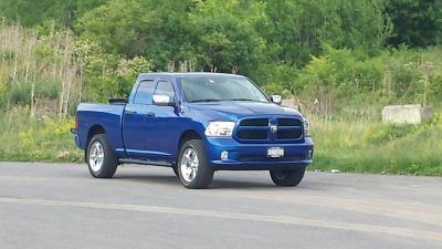

I put the Blistein 5100 Fronts on at 2.1.
For ***** and giggles the first thing I did was to engage 4 wheel drive. Had a hard time getting it out of 4 wheel the first time but since it's been fine.
Not sure if I can post this not being a site vendor, but I got mine last week from Jackit. They had them in stock.
