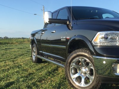

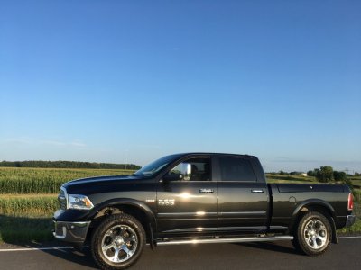

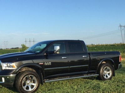

2.1 and dead level for mine
Waiting on the shelf since a couple of months...
-3" PA BL
-Airlift 1000
-Borla Pro XS
