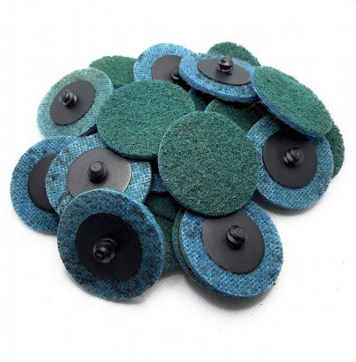

Use these in my little right angle air grinder they work wonderful and save a crap load of time I use the fine ones for contact with aluminuim and use the med grit on cast iron love the Roloc disk's61NSYwA+qNS._AC_SL1500_.jpg 91jEVZ07AzL._SL1500_.jpg

Ramrod wonder if those pads have any abrasives like aluminum oxide etc. In them. Stuff does nasty things to bearings if get into your motor but it's working for you so I guess that's not an issue. Definitely save a metric ton of time. Thanks man

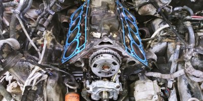

no sealant on head gaskets I have never used a sealant on head gaskets. I used felpro when i done mine they have the blue seal over entire gasket. and the roloc disk do not just clean gasket off and slap the part on its then blowed off then cleaned with brake parts cleaner. For part that you can and should use sealant on this helps the sealant bond to the mating surface. 0219210711_HDR.jpg

I Do not ever remember ever needing sealant on a head gasket worked on vehicles all my life been a full time auto tech working on them 4-5 days a week for over 2 years and never had a issue with a head gasket failing to seal. we always get our heads reworked too so we know we have a good flat mating surface
