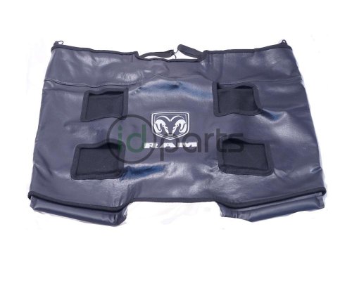

this is a Mopar winter front for your Ram
Wrong winter front for the Gen5 truck.
This is the one he would need: https://store.mopar.com/oem-parts/mopar-cold-weather-cover-82216061ab
More than likely if he has the OEM block heater the truck has the cold weather package which includes the winter front.
