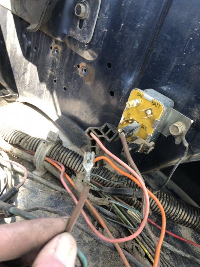

I’m tracking you and agree. So, the bro wire I’m holding was plugged into the EGR sore which is right next to the SOL spade this bro wire runs directly from the battery and doesn’t look factory appears added on. If I unhook this hot I get nothing no “auto start” but no start off key. If I plug that bro wire into the Batt terminals top right same no auto steer but no key action. That bro wire is feeding everything but not switchable?

I know which wire is the ignition but can’t figure out why it’s getting constant power. Well, I do know it’s that brown wire running directly from the battery to the relay. That’s the way it was and don’t know what changed. They did that for a reason?

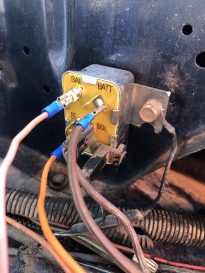

So I ditched that block and just put new spades so you could see where they’re running. Moved the suspect bro wore to the batt terminals and it doesn’t auto start but nothing off the key either?
L
lance1586
Feb 27, 2022
56
Omaha NE
1985
5.2

Low left orange wire is going to I ignition terminal where it was.

I’m not leaving it like this I’ll reuse that block when I finally figure it out.

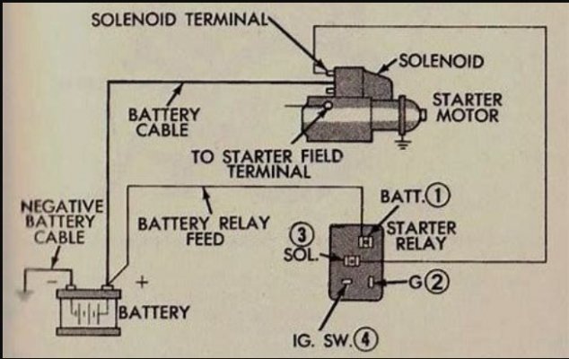

This drawing shows a schematic for the starter relay.
When the ignition switch is moved to the start position, the ST terminal receives 12 volts which then is applied to the relay coil, energizing the relay and closing the switch. This in turn sends the 12 volts from the battery connection to the SOL terminal of the starter relay which is connected to the starter solenoid (small wire on the starter). With 12 volts on the starter solenoid, the starter motor is engaged and cranks the engine.
If the orange wire is the ignition wire, it should have 12 volts when the key is in the start position. Inline with that ignition wire, there could be a neutral safety switch that has failed open or there could be a safety interlock such as the requirement to step on the brake before starting.
So, when you're testing for the 12 volts on the ignition wire during key switch start, be sure to step on the brake while you're looking for the 12 volts.

The ignition wire is lower left I got home late and haven’t had time to check to see if that wire has 12 volts to it. When I hook the bro wire with white stripe to the Batt terminal (either one) I get nothing no “auto start” but nothing on the key either. I can’t for the life of me understand how this was working as it was wired before? I didn’t start monkeying around with the relay wiring until
