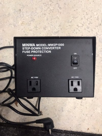

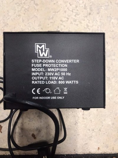

Hi Everybody,
Im hoping somebody with better knowledge than me can help. I live in Norway and winters are cold and long. I own a 4th gen 1500 ecodiesel 2015. I have been trying to get the block heater to work, took a while to find the cord. I purchased a 50F extension cord from the USA (EBay) and found somebody on Norweigen EBay (Finn.no) with a transformer which I thought could work. But when I tried for first time, nothing. I left it running for 4 hours still cold. So either the transformer is wrong or the block heater is not working. Have attached pictures of the transformer. Hope somebody can help. Omformer.jpgomformer2.jpg

Why not buy a second block heater and wire in series then no transformer needed

An inexpensive multimeter will verify both that your transformer is working and will test resistance of the block heater to ensure it’s not open circuit or disconnected sonewhere.
I read elsewhere the heater is 400 watt with a resistance of 38 ohms.
Some people use aftermarket oil pan heaters or coolant heaters that insert into a coolant hose. You could perhaps source those locally to 240v spec if you prefer to not deal with the transformer.
Of course the engine designed for global markets, so I would expect there is an existing 240v part to replace the 120.

buy a extension cord with a light on the end or just the light itself then you can verify everything is working.. In Canada allot of the blockheater cords already have lights in them for a quick visual. I would almost bet that transformer does not have the capacity for the block heater.
The block heater used in the EcoDiesel engine is a PTC 400W @ 115V, same one is used in all of the EcoD's.
The transformer should be big enough for the load, only discrepancy is it's 50Hz instead of 60Hz. This is a resistance type load the frequency shouldn't make a difference.
@JellyBoy your next step woudle be to test the voltage at the end of the extension cord while plugged into the transformer. Also check if there's resistance between the two flat prongs on the end of the block heater cord.
You'll want to have the winter front on the truck and keep the wind from blowing into the front of truck also while using the block heater. Also check the coolant temperature on the dash before you start it, may only read 37°C (100°F) but will drop considerably once you start the engine.

true but those values are only for when everything is warm. Initial startup of the block heater could be much higher. tools and anything with a electrical motor the startup is always much higher that the rated capacity on startup.
As you stated, a higher current can be experienced on start up of a motor load(which can be 5X as much), the block heater is a resistive load. Other than the blip at start up, the current is not much higher than rated. I've never seen mine above 425 watts at a cold start. The block heater is a PTC type which self limits how hot it gets.
