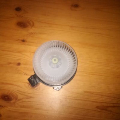

This is what it looks like under the dash and the new fan motor. My newer one has a carpet that covers it. The 11 is open access. 3 screws and a plug all accessible under the dash pretty easily. No need to remove dash. Stick your head in the passenger foot well and look uo
