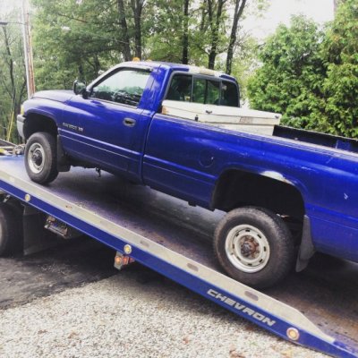

Hi all, Just wanted to say how much of a help this forum is, ive gathered alot of needed information after buying a 1995 Ram 2500 5.9 magnum. Got it off an old man who used it as a work truck for his contracting business until he sold the business awhile back. Truck was garage kept its whole life and was coated underneath too. Picked it up for $1,200. What ive done so far,
New battery, PCV Valve, New crankcase breather filter and hoses, New air filter, synthetic oil change with K&N filter, new spark plugs and wires, flowmaster 10 series muffler, two new front fenders, flushed transmission fluid and installed new filter, and a new tail light (was bashed out) going to check plenum gasket next but truck runs like a bat out of hell when floored, in the process of waiting on ac compressor to arrive so i can get started on that but are there any other things to look out for or check out to make it road worthy besides looking over the brakes and suspension? Again awesome forum!
