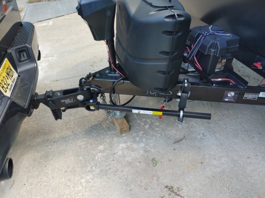

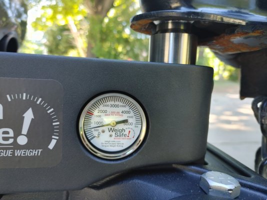

It's done. The beauty of this hitch is that you can adjust the distributed tongue weight (DTW) each time you tow. The tongue weight does fluctuate with each trip. Like now, one of my lp tanks is just about empty. Obviously it'll change a little when I fill it. It's also not loaded for camping. That just involves a few days worth of clothes and food in the fridge. But the fridge is over top the front axle so that won't affect the tongue weight to much. But if it does I can adjust it.

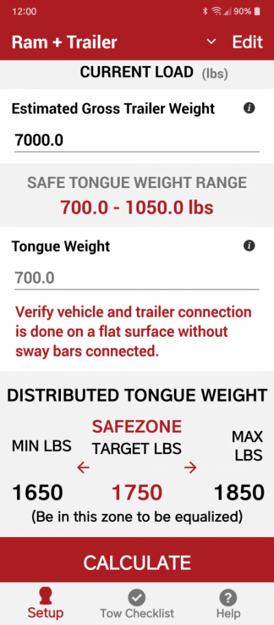

Taking measurement was easy. They have an app you plug the numbers into and it tells you the DTW that you need to be at for proper weight distribution. All you do then is adjust the top nut until you reach it. That weight has a min and max range and the app tells you all that.
They ask for the estimated trailer weight. I went with 7000lbs. My last trailer had a dry weight of 6500 and a scale confirmed camping weight of 7500. This trailer has a dry weight of 6000 and we have pretty much the same stuff in it so I think this estimate is pretty close to camping weight. According to the tongue scale the trailer tongue weight is 700lbs. That will go up slightly when loaded for camping but you get the actual weight each time you hook up so if it goes up I adjust accordingly. But the beautiful thing is I'm at 10%. It'll go up slightly which means I'll be in the sweet spot of about 12%.
The entire set up feels like quality so I have to no reason to doubt the accuracy of the scale. The draw bar and hitch head assembly weighs 75 lbs. In comparison my EQ only weighs 50lbs. I do have room to drop my tailgate when hitched up and my safety chains are a few inches short.
I'm happy with this so far. I'll see how it performs in a few weeks.

I finally had a chance to tow with my new hitch. It's great. Only went on country roads 50-55 mph. I felt very confident with it. The app did lose the measurements I had to input for the calculations but I remeasured them and took a screen shot. I should have done that the first time.
My tongue weight went up. When I weighed it before I was partially loaded with 1 empty propane tank. This time I was loaded and both tanks are full. It went from 700 lbs to 850 lbs. (It's so nice having that information.)
I compared it with the Better Weigh app I bought last year. The Better Weigh had me at 1000 lbs. I always thought it weighed heavy and I was right. I trust the True Tow more the the BW. I've seen some reviews that said the BW wasn't that accurate but I couldn't find any complaints about the accuracy of anything Weigh Safe made.

Hey Loudram, i've got a dumb question about your Weigh Safe hitch... The scale on the hitch tells you the tongue weight, right? You said you are in the 700-850 range. Then the app tells you the Distributed Tongue Weight range - the image you posted earlier was 1,750. You then crank the nut on top of the hitch until the scale is at that target weight.
My dumb question is this: does this weight - 1,750 lbs - count as tongue weight? Does it count as payload? Is there a way to calculate where that weight is going? Front axle? Rear axle?

My tongue weight is 850 lbs according to the scale. That's the tongue sitting on the hitch without the bars attached. The other weight is the distributed weight. With 850 lb tongue it's 2100 lbs distributed. That number is with the bars on.
The 2100lb number on the scale comes from the weight of the tongue pressing down onto the scale and the pressure of the bars pushing the hitch up against the trailer tongue. I'm this case the only number you would be concerned with is the actual tongue weight. The 2100 lbs has nothing to do with payload capacity.
