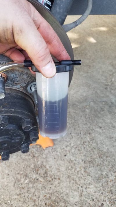

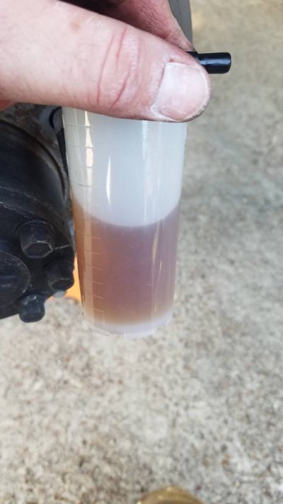

Well I flushed out the old brake fluid this weekend with Castrol DOT 4.
This is what I used.
Castrol 12614 Dot 4 Synthetic Brake Fluid https://www.amazon.com/dp/B0002JMAKW/ref=cm_sw_r_cp_apa_T7.WBbPX8C03R
I went with DOT 4 just because it handles heat a little better than DOT 3 and they are both compatible.
I ordered 2 of these 32oz bottles. I'm glad I did because I used every bit of it.
I have a large vacuum pump that I used to suck out the old fluid from the reservoir.
After I did that it took a whole 32oz bottle to fill the reservoir back up.
From there I used a hand vacuum pump(harbor freight $24) at each brake caliper to suck the old fluid out untill new fluid started coming through.
It's amazing how dirty your brake fluid will get. My truck is 4.5 years old with 61,000 miles on it.
So over the course of bleeding the old fluid I went through the entire second 32 oz bottle of fluid and had just enough to top the reservoir off when I was done. Worked out perfect.
Anyway here are a couple pictures of old dark fluid and the fresh lighter fluid.
Hope this helps anyone that might be needing to do this.a148b2b9f72b9672fd3dc552692eb1be.jpg9e4d4ef032167661e06fb44bc4845c67.jpg
