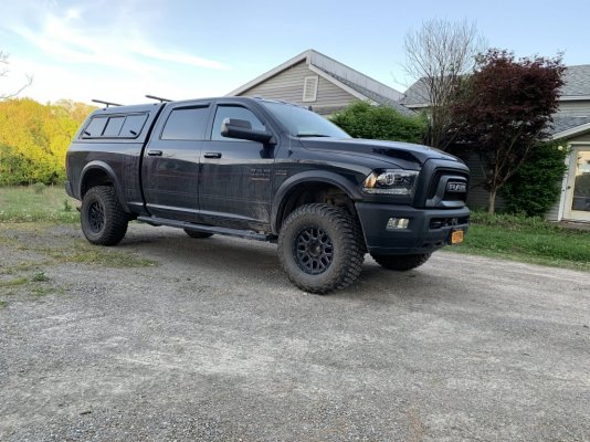

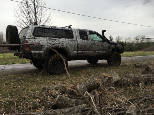

Love my PowerStops! I’ve run them on all my vehicles! Noticeable improvement on all of them! I’ve never had a problem, or had to replace, any of them! Basic maintainable of calipers(regressed sliders and rubber boots)! I live in the rust belt…I installed PowerStop’ powder coated calipers!
‘18 PowerWagon
‘00 WS6 TA
And my old ‘06 Tacoma!
