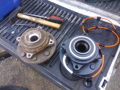

I just bought a NAPA Fleet. Spent all weekend waiting and searching for the axle nut. Found one today. Local RAM dealer and all the parts stores didn't have it, so I got to travel to the 3rd furthest one. They only have one.
Be sure to check on them when you go to do it.
Mine has 139599 on it. Noticed the tire wearing to the outside. And just heard the growling. It now has about 1/4 inch of play wiggling the tire.
Hopefully finishing mine tonight

The axle nut? It is a one time use nut. My 2nd and 3rd gen have the style with the cotter key (castle nut) when I was looking for the size socket for the nut it said it was the same for 1994 to 2018...wrong. It is much smaller. My 99 and 03 use an 1-11/16...this one may be 1-5/16...but waiting til I get it before I listen to the internet.
In the spec for the nut it says one time use...when removing replace with new. So...i had to wait on a nut lol.
The wheel bearing...it didnt break...and i could still drive it...but I parked it for the time being...will hopefully be driving it tomorrow.

NAPA Fleet. Only one that was available without waiting a week for it. NAPA girl said it was their best one. And it was much cheaper than the Moog they didn't try to force me into
Interesting thing is that it is actually coated...so it won't look all rusted tomorrow.

I'm not impressed with Moog, (got some suspension components for Dad's Toyota that were crap), I got SKF as I came across a thread that had mentioned they were the OEM manufacturer for Mopar.

Got the nut and added another socket to my collection.
Size is 1-5/16"
As soon as get home the tear down will begin

Oh, I should mention my 2010 had a larger than 1 11/16” nut, I tried 1 5/8, 1 11/16, couldn't find 43mm. Ended up using 1 3/4”, which was slightly loose, but worked fine.
This is fresh in my head, because it was only last week, and I was driving all over trying to find the right socket.
EDIT: this info is probably not for you guys, as I'm pretty sure mine is different than your later models, mine still has the cotter key locking nut which is not one time use, and is larger than yours...
