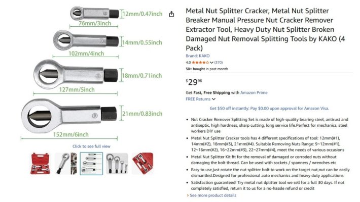

IMHO, U need to find a new shop there ref brakes/tires. Posts #5 & 6 combined, may be your best choice. I have used a cold chisel and cut off locking lugs before, but that is a monster way to do and U also risk doing some damage, to the point of even having to replace the stud affected. U could also buy a HD nut splitter and attempt to split off the part still on there. U can torch those nuts all day, but unless U burn them off, U still have to get something on the part to remove. You might be able to go to an autoparts store and buy (1) BIG splitter instead of a set. TBH, for the price, I would just buy the set. Good luck.
I cant see that tool working unless the lugnuts stick out
And if they do that...he would probably have steel rims and he wouldn't need security lugs

Good catch had to think on it. Just another option. I chiseled a set off of a RAM and it took forever but eventually got them off.
The ole slightly smaller socket jammed onto nut had been used too. They got YouTube videos out on how to defeat a locking lug quick.
