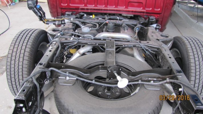

Maybe take the Bed off the truck
Then bolt a 2X4 across the rear of the frame
Put temporary Tail lights & the license plate onto the 2X4 & drive to the repair facility.
They would be hard pressed to charge $1300, if they had access with the bed removed

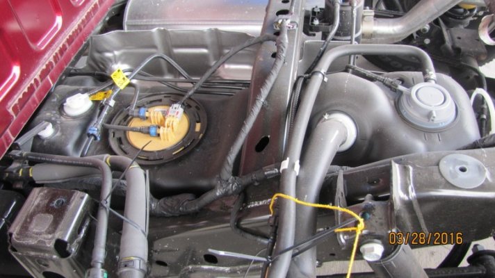

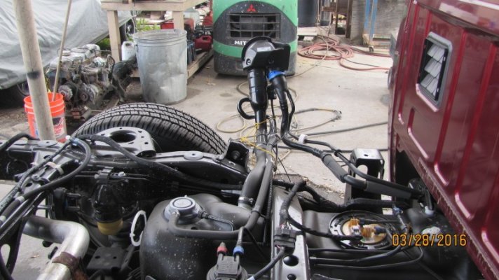

I can't tell if taking the bed off will help, i don't know where the melted part is located
Look like the complete DEF tank is under the cab, in the front left corner of the of the Fuel tank
Pulling the bed off won't help, the DEF injector, supply line and flange is roughly under the front passenger seat.

After looking at the next to last image
I could see the back of the DEF tank & the hoses & i figured that the melted parts had to pass near the front of the fuel tank to reach the Exhaust
