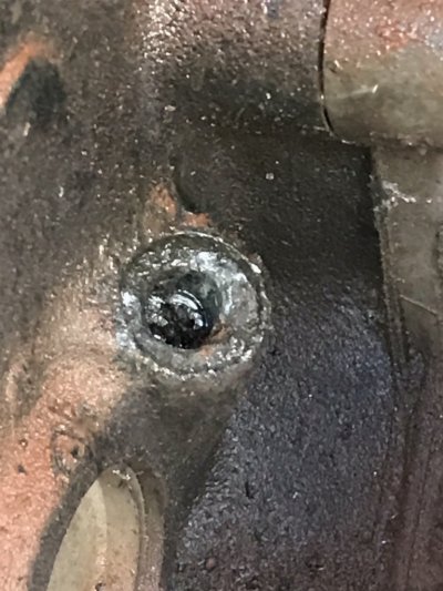

hello I really need help for my 96 Dodge Ram 5.2 oil is stuck inside the block..

Need help removing my oil tube that's stuck inside the engine block.

What is stuck in the block? The metal tube for the dipstick? or the dipstick itself?

If you cant get a pick in there to pull it out, you'll have to drop the pan and drive it out from below.
5.2
I had that on my 6.0 Chevy. I had to cut the tube and use some PB Blaster, then an easy-out to get mine out. I then had to use a long flexible rotary wire brush to clean it out before putting the new one in. There's no way to stop the particles from getting into the crank case, so change your oil right after if you end up having to go that route.

From under the truck I was able to get a screwdriver on the bracket for the retainer bolt on the dipstick. Hit the handle of the screwdriver with a hammer a few times and it came right out. On another one I did a while back we were able to pry on the ridge that acts as a “stop” for the tube going into the block.

My bracket was broken and really the reason I was replacing it. I was assuming his was too.

But the 4x4 axle housing is in the way, for me to able to see the oil tube hole from the oil pan.

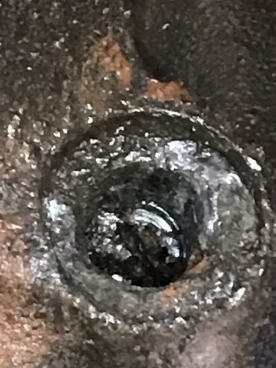

Sorry this was on a 96 Dodge Ram 1500 4x4 d68dc24f4004c45f6b62d31168bede89.jpg0c4d8868cf1ecd5c409da7d7fadeaf46.jpg3a03a621d19354b10b7d9de1faabae47.jpg

I would use an easy-out.

Knock it into the pan. U should be able to fish it through the drain.

Do that and you'll have to pull the pan anyways. Drain bolt is able to be threaded into the pan because there's basically a nut inside thats welded to the bottom of the pan. Part of why you need to be careful not to over-tq a drain bolt. You will NOT be able to fish it out

I would drop the pan bolts slide it over a touch and get up in there and tap it out from inside out then grab w some visegrips
