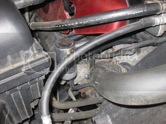

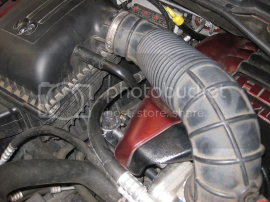

Got my new BT catch can installed today! All went well except for a missing bolt, but no biggie. I am taking a ~2000 mile trip to Florida starting tomorrow and I will be interested in seeing how much oil accumulates in the can on this trip. This is the standard satin can with free hoses, nothing fancy here.

tiny little thing aint it?

It's smaller than I expected...

It's an oil catch can. The PCV valve normally takes blowby oil and dumps it back into the intake for the engine to burn. This goes in-line with that system and filters out the oil, then you just dump it out every few weeks or so. Keeps all the old oil from being burned.

I don't think it's an issue on the 3rd gens, just the redesigned 09+ Hemis. But anyways, got this one directly from Billet Technologies for $135 shipped, installation takes about 10 minutes.

Thanks! It just protects the engine, might be a slight performance increase from not burning oil, but it would be negligible.
