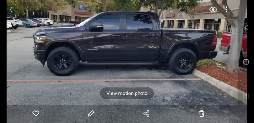

Bilstein 5100 adjustable struts set at 2.1", can go up to 2.7" level in front. Have 285/85R18 ridge grapplers on it(almost 35"). Could be considered an off road "4x4", but she a 4x2. Have 3.92 years and locking diff.

Do 5th gen 2wd's use struts? OP's 4th gen does not use struts in front, that's a 4wd only thing. 2wd's are best lifted with a spacer, a spring or a spindle depending on lift height desired. The spacer "problem" that exists on 4wd 4th gens, doesn't exist on 2wd's because there is no strut to put the spacer on top of.

You are correct, shock. In my opinion I dont like spacers that squeak and with a bigger spring still have to get a longer travel shock. Bilsteins are a great and cheaper alternative using factory coil...but that said, I cannot say how a spacer or coil feels or ride it gives.
