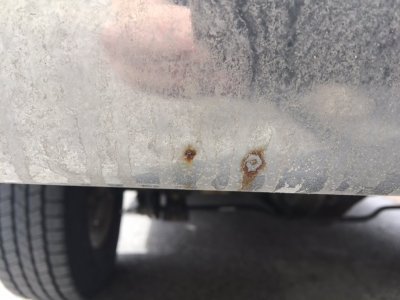

Here you go. You can see that one of the rust spots seems to be bleeding from under a patch of chrome, so in my opinion, it's definitely coming from the inside out.
There are numerous smaller rust spots and dark spots appearing.

Is it coming from the bacl side and rusting through ?

You live in a snow state? I see them saying it is related to road salt.

It is not an issue for FCA until it rusts right through and by then your warranty will be done.
Clean it up now. Wash the truck and hit the bumpers with never dull, then wax them with whatever you use on your truck. You should also use a rust inhibiting undercoat like Krown, Fluid Film or whatever you have in your area. Have the whole truck done underneath every year before winter and make sure they hit the backsides of the bumpers.

As a follow-up...just got a call from the FCA dealer. I'm being given a new rear bumper!
