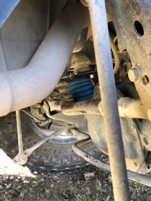

I just got done putting the blue sumo's on and taking them out for a test run. I did not use the plastic spacer so I've got a little bit of room between them and the axle with the Bilstein 1" springs and the TGC .75" spacer. Didn't really lose too much in the way of articulation, but the 315's are just a little bit further out from the liners with a good bit of weight transferred back into a rear corner. Hitting ruts or rowdy rural RR crossings at speed is quite a bit bitter than bottoming on the stock ones. They are a bit noticeable, but not really harsh on the engagement just can feel it firm up as they compress. I imagine a lighter truck might be a bit rougher with them, but I'm happy with em for what they are without changing springs yet again or fabricating something for cans. Once I get my kings installed for more down travel along with the Daystay 1" spacers I should have my articulation back past the little bit I lost with the bigger stops.
as for the color... they'll be brown soon enough so it didn't really bother me.

With that 4.5" rear lift you'll probably want to use the spacer thing they come with that makes the bumpstop 1" longer for constant load support on a stock truck. Depending on where you want to limit up travel you might even need a bottom pad like the ones @ram1500rsm is running.
These things are far from perfect, but for me with the softer Billstein springs and the extra weight they seem much better without the effort of bumpcans. Not bad at all for re-purposing a product designed for load support.
Here's where mine's sitting in current form :
