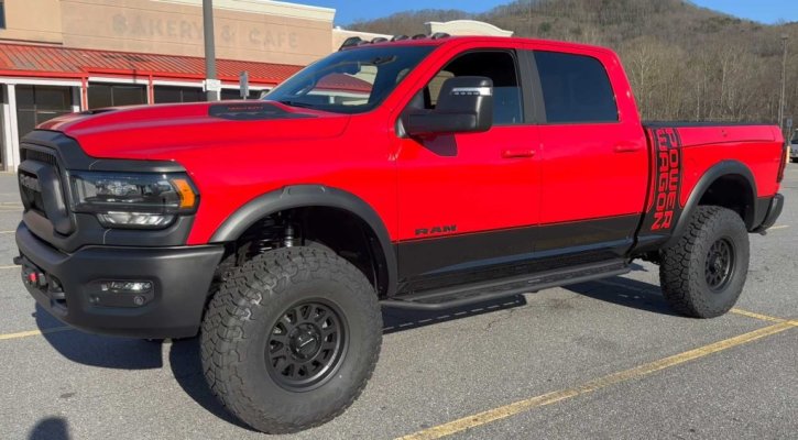

I previously had a 2019 Ram Rebel 4x4 and it rode smoother than my stock 2024 Ram Power Wagon. I have since changed out the coils, shocks, track bars and tires to Thuren/Carli components and Toyo RT Trail 37s. After changing out the suspension components and having lower tire pressures (currently run 40 psi front and 35 psi rear), the beast rides smoothly now and similar to my prior Ram Rebel truck. With the front solid axles, it definitely handles a bit different than IFS style trucks. However, it is a beast offroad.
