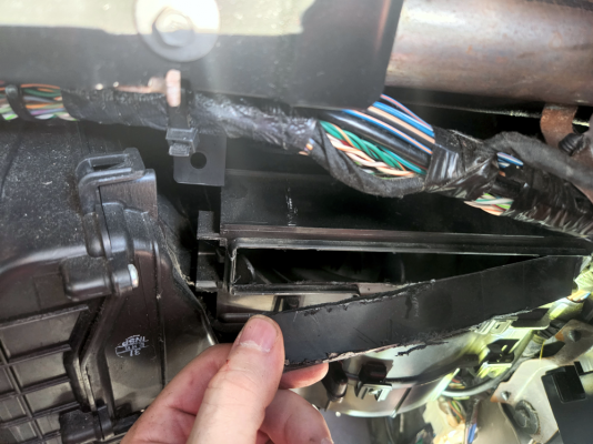

My RAM didn't come with one, so I had to install it. You need to Dremel (if that is a verb) out the space inside the raised area.
My Dremel wouldn't reach the entire space, so I used a sharp box cutter to remove the rest.

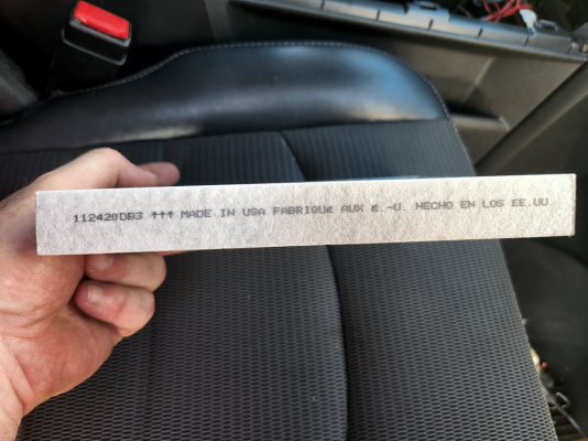

I cleaned the rest of this up with the box cutter and then installed this air filter. Made in USA!!!!!

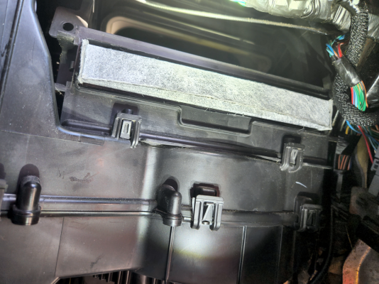

Air filter inserted and ready for the cover.

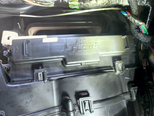

Cover snapped into place, it looks factory. It was a little tricky to get both sides snapped in place. The trick is to get the right side snapped first (because it's harder to get to) and then snap in the left side. Fits like a glove!
